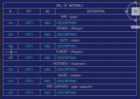

The IsoConfig.xml looks perfect! There is, however, one other thing you need to do. Now, that you have a way of identifying & grouping instruments, you will need to 'define' an area (or a row template) in your Iso.dwt template file so that the iso engine knows that it has to populate that area with the newly created instruments group. If you open up the Iso.dwt file, this is what it would look like.
BOM template
Just copy and paste the 2 rows for 'VALVES <valves>' and rename it to 'INSTRUMENTS <instrument>'. The value in the angle brackets is the label that helps identifies what components should go in there (This SHOULD match the label in the newly created group in IsoConfig.xml)
That's it. Try it out and let me know. Hope it works!
-Karthik
