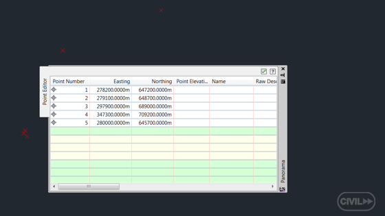

1. Get your pure data

4. Create a new Point File Format in Autodesk Civil 3D and call it e.g. PEN(semicolon) with settings:
- Default file extension .csv
- Comment Tag #
- Format options Delimited by ;
5. Import the points to Autodesk Civil 3D from your CSV file

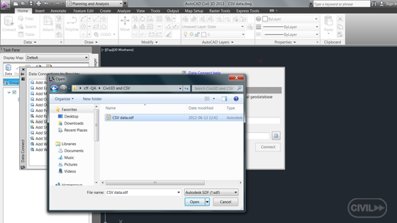

7. Change the workspace to Autodesk Map 3D (Planning and Analysis)
8. Type a MAPWSPACE command and choose On
9. Connect to the SDF file

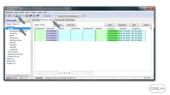

12. Export Layer Data to SQLite

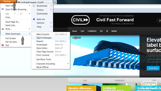

13. Open the Mozilla Firefox browser
14. Install Extension called SQLite Manager from Mozilla Add-Ons
15.
From the Mozilla Firefox browser choose Web Developer and open SQLite Manager
16. Open the SQLite Points base exported by Autodesk Map 3D
17. Open the table called Points, select Stucture and copy the statement (mentioned below) to the notepad for future reuse in next steps:
CREATE TABLE "Points" ("Autogenerated_SDF_ID" INTEGER PRIMARY KEY, "Geometry" BLOB, "Name" TEXT, "Description" TEXT, "RawDescription" TEXT, "Number" INTEGER, "Elevation" REAL, "Latitude" TEXT, "Longitude" TEXT)
18. Select Points, choose Export Table and export the data to the CSV file Select the checkboxes: First row contains column names and Fields separated by Semicolon ( ; )
19. Select the exported Points table and delete it

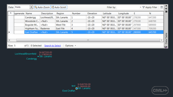

28. Finally you will get your points from Civil 3D with data from the CSV table, other words you have just inserted all pure data
If you check the result - geometry matches the description.
