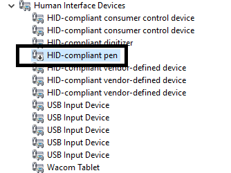

We found a simpler work around that seems to be working on all machines impacted.
Right Click on the "start menu"
Click Device Manager
Expand: Human Interface Devices
Right Click on "HID-complient pen"
Disable
You should see a down-arrow next the the icon. So far this has corrected all crashes related to the pen device.
This is NOT a wacom issue from what I can tell.
Autodesk will likely patch the issue when/if they extend support to windows 10. Many of the autodesk tools have not even been built on windows 10. I suspect it would take autodesk a little while to validate and qualify windows 10.
Message 22 of 43
I should mention I found this issue by loading the crash into MS visual studio 10. Looked at all the dll's called. And one poped out that pointed to the pen device. An Autodesk rep suggested disabling the "HID pen" device. The moment I did that all crashing seemed to go away.

EC_SB
Hi AJ,
tcomputerchip's solution worked for a while. I just had the problem creep up again so I tried ylustrat's solution and issue disappeared.  (I use Wacom tablet CTH-680)
EDIT:  Side effect of ylustrat's solution is that pen pressure is ignored in Photoshop, so not an ideal solution.
