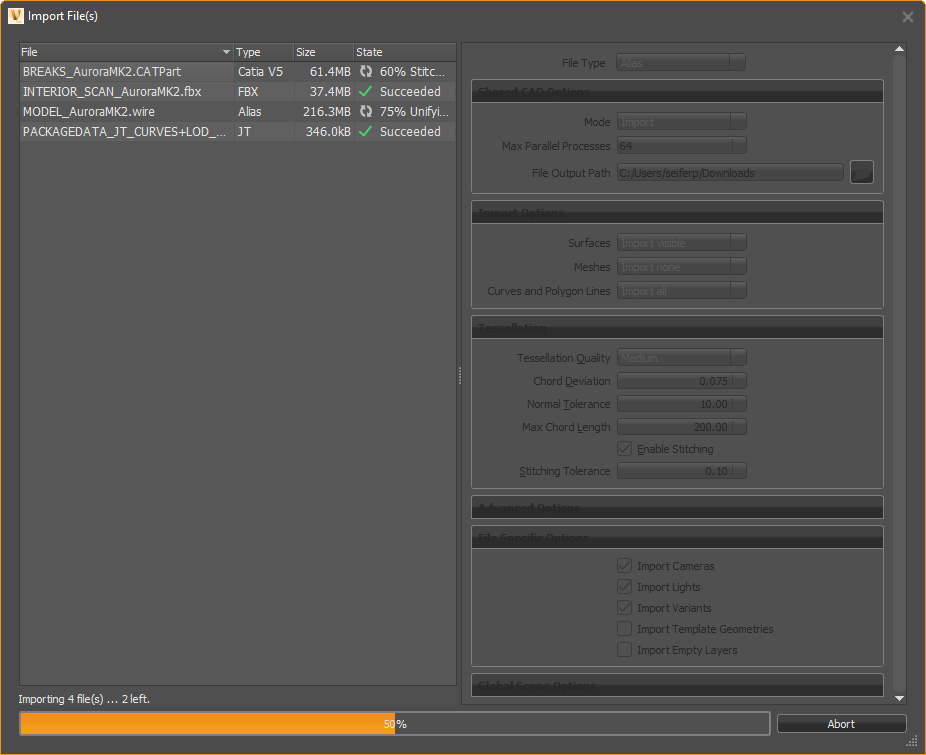

File Type Specific Import Options
  • File Import was completely re-designed. Menu entries have been re-arranged to work more intuitively and similar to other Autodesk Products. File > Open now supports only VRED-specific file formats like .vpb, .vpe, and .vpf.
  • The Add File menu entry was removed and its functionality is now covered by the new File Type Specific Import Dialog. Now it is possible to set individual import options for different file types during one import process. We have introduced a list on the left for batch import and it is possible to Add or Remove files and folders. Only available file options are shown on the right for the file formats that have been added to the import list.
  • We added an Import State Overview to give more reliable results/reports, which are also stored in a Logfile.

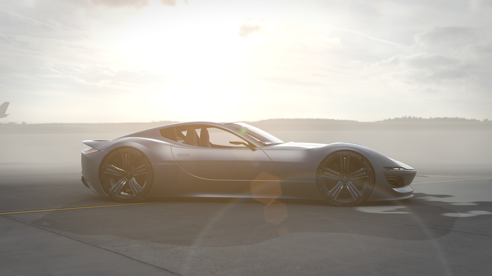

Camera Fog
  • Cameras now support classic Fog as part of image the processing. It is possible to adjust the Distance- and Height Fog independent from each other. This is a simple effect to add more realism to help someone better understand the distance and scale of objects by fading these in the distance.
  • Some parameters were added that can be animated and are accessible via Python, such as Noise to add irregularities to the Fog.
  • It is also possible to render the Fog an Lens Fares into a separate channel in the Image Processing Renderpass.Aurora_OGL_Fog.png

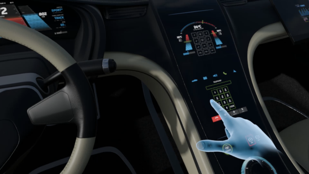

VR Hand Interaction
  • When starting the OpenVR or Oculus HMD Mode, you will see pre-posed VR Hands with different gestures, instead of the HTC VIVE and Oculus Touch Controllers.
  • It is possible to interact with HTML5 Content and TouchSensors. Therefore, the collision geometry has to be registered via Python Script (see VRED Examples).Hands.png
