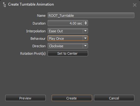

I can right click the node in the scenegraph and go "Edit > Anim > Create TT Anim"...
I get this pop up window:
But when I click 'Create' it disappears and I don't know where it saves the animation?
 - Any idea where it goes? Smiley Sad

unfortunately the create turntable functionality from the scene graph is not accessible in VRED basic. However, as dawn suggested, you can create an animation with the wizard of the clip maker. Instead of rotating the camera you will need to rotate the scene and the environment material to create a turntable look. Therefore select the object(s) in the scene as well as the environment material in the material editor (e.g. studio), open the wizard and select 'Object and Material'. Select your time range and capture the start state. Now add 360 (degrees) to the z-rotation (ry for y-up scenes) value of your object(s) (you can do this in the transform module) as well as the 360 (degrees) to the environment transformation rz (or ry) of the selected material. Capture end state and your done.
