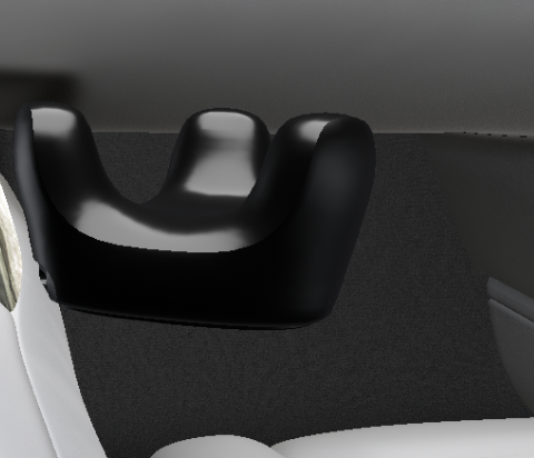

Hi All,
is there a way to hide it ?
Regards
