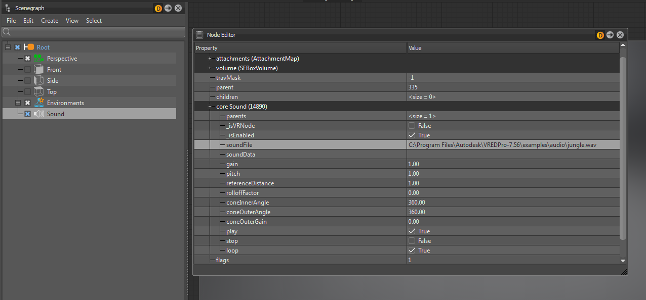

How do you import a sound file into the Node Editor?  I don't see a browser and drag and drop doesn't work.
3,726 Views
18 Replies
Replies (18)
Message 2 of 19
dlincol1
From the Scenegraph menu select Create, Sound.
Then edit the Sound node and change the soundFile attribute to be the path to your wav file.

sinje_thiedemann
Hi, dropping the wav file onto VRED doesn't work. You need to set the path of the .wav file in the Node Editor, see attached screenshot.

sinje_thiedemann
Do you hear something when you load the example file 3DSound.py?
I noticed that it's a bit tricky to enter the path in the Node Editor. You need to enter it without quotes. With every character that you're typing VRED tries to load the file, that's why there are lots of error messages in the Terminal as long as the path is not complete.

Heads up, I think I figured this one out...
When you point to a new sound, do NOT use "", paste the whole path. The sound might not play. Save the file with play ON, then close and re-open VRED, it should now work.

By the way according to my attempts, i get success with only 44100.0 Hz and 16 bit wav files !
And they have to be stand in the `root`, if you would like to make them all in one group its also doesnt work.
