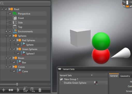

I have created Variant Sets via the Simple UI Capture feature and would like to switch between these Variant Sets when in Collaboration Mode with another PC. However, for some of the VSets, certain nodes get hidden for the Slave PC when the Master activates the VSet. These nodes are neither in the Geometry, nor in the Script tab of the VSet. Therefore, I don't understand why they get disabled on the Slave PC, but enabled on the Master PC.
EDIT: After some more testing, it seems to me as if the VSet gets handled differently for the Slave than for the Master PC:
The Master PC enables ALL nodes and then disables the ones that are specified in the Geometry or Script Tab of the VSet. The Slave PC ONLY does whatever is specified in the VSet. Nodes that were inactive before remain inactive, whereas they get set to active on the Master PC if not specified otherwise. Can anyone confirm this and tell me what the best way is to fix this problem?

I created the VariantSet "Disable Green Sphere" with the SimpleUI. When you activate it as the Master, every node except the green sphere will be enabled, while the green sphere will be disabled. On the Slave PC however (if Master activates the VSet), all that happens is that the green sphere will be disabled. Every other node remains in the state it was in before, disabled nodes will remain disabled.
Let me know if you experience the same issue with this session (and any other session using Simple UI VSets and Collaboration really).

I can reproduce the issue and added a bug-report for it. Unfortunately, I can't tell when it'll be fixed.

the captured states are currently not correctly updated when the variant set is switched during a collaboration session. Until this is fixed, the variant set could be switched with a synchronized python command.
vrSessionService.sendPython("selectVariantSet('Disable Green Sphere')")
In this case the captured states are updated correctly.
Marcus
