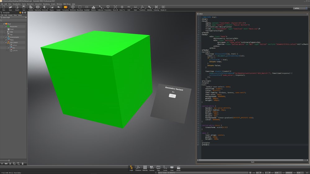

seiferp
I´ve attached a simple example.
hobbotuk
Crazy!!!
This is exactly what aI was lookinf for!!
Thank you sow much to both of you!
