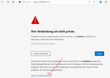

YES!
At least should show this (s. Picture).
... and sure, the regular browser will initially complain, but there is a dialog to ignore the certificate or security problem, and then it works until you clear the cache.
[cid:image001.png@01DB427A.00C49C50]

Message 8 of 8
"Oops, I just realized that when I click on REPLY, I am not logged in and therefore cannot upload images, very strange...
Never mind...
When I edit a front plate with "https://localhost:8888 ", I expect to get the same dialog as in normal browsers (Chrome).
Clicking on the button expands to
then clicking on the link "localhost" and voilà
that's what I want to achieve.
This is just an example for a local https service, which almost never has an official certificate:
The only thing missing in the VRED front plate is the dialog (see images).
Instead, it just doesn't accept it.
There are two ways to solve this:
1. Allow https with unofficial certificates in general through a preference setting (preferred)
2. Apply the dialog as in normal browsers
