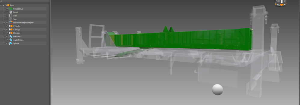

Unfortunately i have to put 3 cylinder i my model and 2 of these must rotate with half of the structure...
This is a simplified view of the first cylinder
and this is what i need to do...
... to much work only to see something "beautifull" ...
thank you

i have the piston, made of two parts...
i have to set the pivot of the twoo pars tin the joint, correct?
i have to put each part inside the mobile object?
the sphere, mast be in the origin of the scene?
thank you
