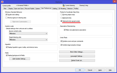

ВeekeeCZ
Why you have to turn the osnaps off? Because of this setting of yours:
Why putting non prior all point user inputs within command works? Because of THIS feature, specifically the last item in the list.
BTW  None you should also add prior points defying the rectangle.
