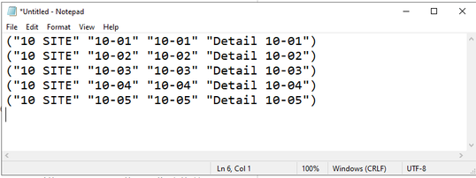

I have a lisp that we use for a detail library. Keeping the txt file it references up to date as we add and remove details is time consuming to say the least.
This morning I've been trying to peice together something to make this easier. A way to process the folders and creating txt files in the folder that I could cut and paste in to the master control file.
The program reads a text file that is formatted like this:
("Folder Name" "Drawing Name" "Drawing Name" "Description")
Sample:
("10 SITE" "10-01" "10-01" "Detail 10-01")
("10 SITE" "10-02" "10-02" "Detail 10-02")
("10 SITE" "10-03" "10-03" "Detail 10-03")
("10 SITE" "10-04" "10-04" "Detail 10-04")
("10 SITE" "10-05" "10-05" "Detail 10-05")
So the user selects  a folder,
The list of drawings (.dwg files) is created,
The list and folder name are used to create a .txt file formatted as described above.
I started "franken-lisping" this morning and this is what I have so far.

  1. The result you posted is the product of the program after reading the  contents of the text file? No. What I posted is what I need the text file to be.
  2. Or are you saying the content is exactly like that on the text file?Yes, I need the ofrmat to be like that in the text file created.
  3. The "Description"  value is always "Detail <filename>" ? Yes, the description is always "Detail <filename>"
Here's a quick mod of your code:
(Defun c:parts ( / AllDrawingFiles FNBase WriteToThis penultimatefolder)
(if
  (and
   	(setq f (acet-ui-pickdir "Select project Folder"
		  			(if f f (getvar 'dwgprefix))))
	(setq AllDrawingFiles (vl-directory-files f "*.dwg"))
	(setq FNBase (strcat f "\\" (vl-filename-base (getvar 'dwgname)) ".txt"))
	(progn
	  (setq WriteToThis (open FNBase "wr"))
	  (setq penultimatefolder (vl-filename-base f))
		(foreach itm AllDrawingFiles
		  (setq fn (vl-filename-base itm))
		  (write-line (strcat "\(\"" penultimatefolder
				      "\" " fn "\" " "\"" fn "\" " "\"Detail "
				      			fn "\"\)") WriteToThis)
		(close WriteToThis)
	  (startapp "Notepad" FNBase)
  (princ)
HTH

This is what I was looking for. Is it possible to remove files in the folder that are named "0A*.dwg" from the list?
Message 10 of 10
DC-MWA
I figured out the file removal.
This awesome!
