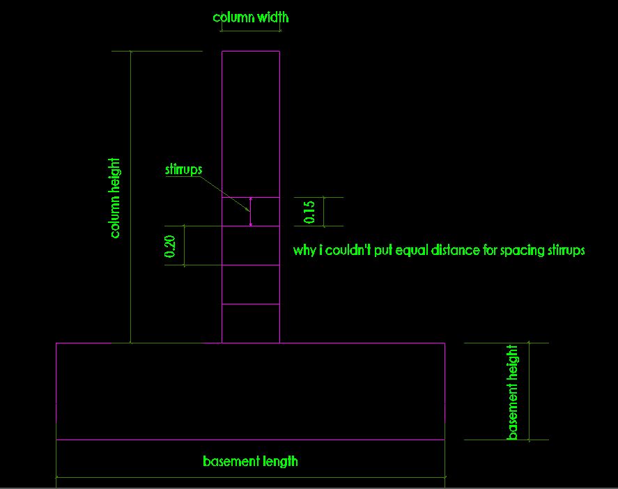

hi everyone.
i attached the lisp.
kindly help this problem as shown below.
1.when i do the first time in the drawing totally collapsed itself. i don't know why appears it's like this after that second time it looks good.
2. In this lisp, some information missing I am pretty sure, i wanna put equal spacing for stirrups, but, so many times i tried. it did not come. what is wrong in this lisp?
thanks advance
hussain

ВeekeeCZ
The LINE command does not have any "c" option as for Closing or what. You've probably wanted to make a Pline.

hi beekeez
i tried already that one what you mentioned, but it did not come correctly. see the image which one i attached.
did you check my lisp?
thanks
hussain
Message 4 of 14
ВeekeeCZ
That's another thing. Always turn off osnaps!!!
BTW I wouldn't know what is correct output. You gotta give some real measurements.

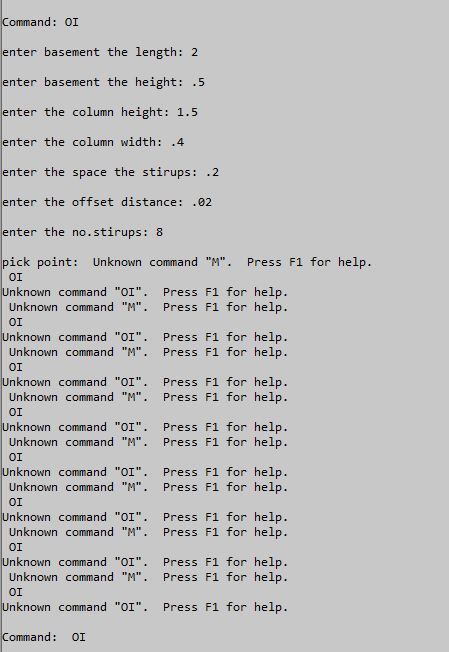

thank you so much your reply.
your function little bit helps me, but when i execute lisp showing unknown command. why it's showing? kindly help.
i have shown below for your reference.
@Moshe-A wrote:
@Anonymous  hi,
here is a correct code but in this case you will not achieve much, better run the original command.
moshe
 (if (setq ofd (getdist "\nOffset distance: "))
  (command-s "._offset" ofd pause "_m")
for checking.JPGthanks

Message 13 of 14
dbhunia
Another way (roughly modified) ....... try like this .......

hi dbhunia
thank you so much. it works fine.
Insha Allah, i will use this code particularly (copy function) for my next lisp . it just really helping me.
i appreciate your help.
regards
hussain
