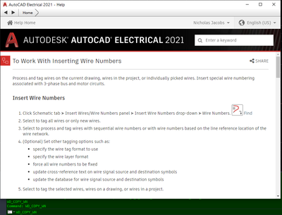

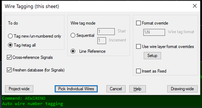

Here is the Button for AEWIRENO:
After executing the Command:

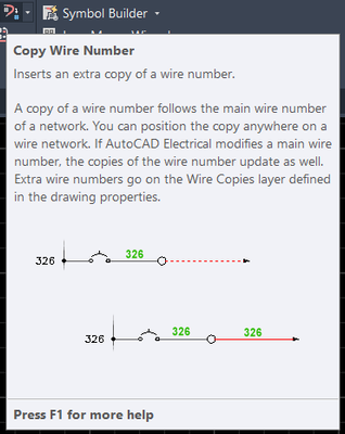

Here is the Button for AECOPYWIRENO:

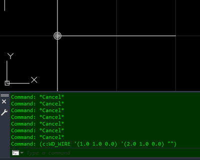

This Command is entered differently through Lisp Format.
For Example:
(c:WD_WIRE '(1.0 1.0 0.0) '(2.0 1.0 0.0) "")
This draws a Wire using two Coordinates.
