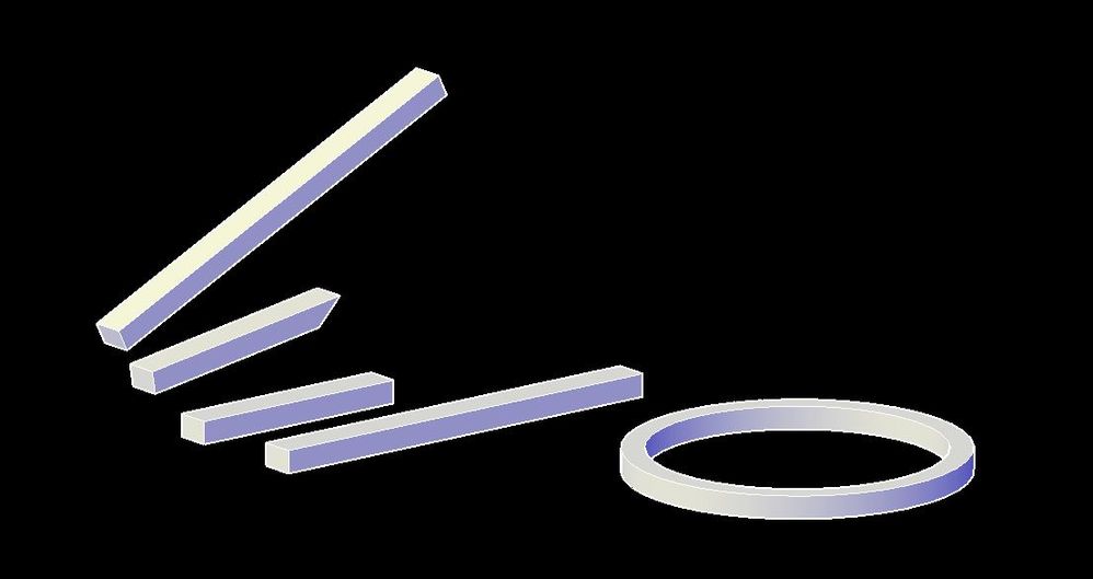

Im quite new at creating lisps, but my first one is already kicking my butt. Heres what I want the lisp to function, and hopefully someone can help me write this up. Thanks in advance.
I would like to be able to select multiple 3DSolid objects and have it calculate the total Linear Footage. In my mind, this is how the workflow would go?
1. i have 3 objects i will be selecting
    1. 2 x 2 x 12
    2. 2 x 2 x 24
    3. 2 x 2 x 36
2. freeze all layers but the layer my solids are on.
3. enter lisp command to calculate
4. window select all the solids i wish to calculate
5. lisp grabs the volume result of 288
6. cmd line asks me for the "width 1" of tube - i would enter a value of 2
7. cmd line asks me for the "width 2" of tube - i would enter a value of 2
8. lisp has some formula like:   (288/(2*2))/12
9. an alert window pops up informing me the result is " 2in x 2in x 6LnFt "
10. I then become a happy camper.....

@ronjonp came very close to what im thinking. though like @3wood noticed, it wont recognize solids that are not parallel to a UCS. or it doesnt recognize curved solids either.
@Sea-Haven i couldnt seem to get your example to run.??
this is why in my original post, im thinking that the command line can prompt the user to ask for the width & height of the solids. that way a calculation can be done with that info with the volume info. this way, solids that are rotated and even curved can be  counted in the final result.
and perhaps with some extra input from the user when prompted, with the volume info, we can have weight listed too in the alert..... just a thought.
in my pic, is an example of the various types of solids that i would wish to select. lsp total Lnft2.jpg

@SinCity_XTRM wrote:
.... im thinking that the command line can prompt the user to ask for the width & height of the solids. that way a calculation can be done with that info with the volume info. this way, solids that are rotated and even curved can be  counted in the final result.
So for the one with an end that is not perpendicular to the length:
if a routine divides the Volume property by the height and width, the result will be the length to the mid-line of that slanted end, halfway between the lengths of the top and bottom surfaces.  Is that appropriate?  Or would you want the greatest-extent length [here, the length along the top surface]?  Or maybe the bottom surface?  Not that I have an idea of how to calculate those, but....

this would be appropiate. im going to use this lisp for material ordering. so i'll take that value and add a % to it anyways for the cutting etc.
