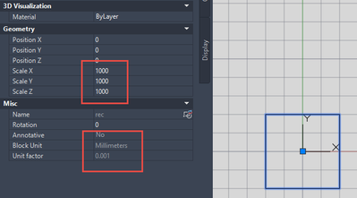

I'm using the vla-InsertBlock method to insert the blocks on the position of the text, with the text's rotation. But if a block definition has different units than the active drawing, then the block gets inserted with an added scale factor to compensate for the different units.
For example,
rec= block 1000x1000 mm (1x1 meter) - defined in mm
target dwg= units=meter
(vla-InsertBlock ModelSpace (vlax-3d-point '(0 0 0) ) "rec" 1 1 1 0)
The block "rec" will be placed with both the Unit factor 0.001 and the scale xyz 1000. The latter should be 1. This results in a block that is a square km instead of a square m.

This is an example excerpt from vlax-dump-object on the block in the above demo .dwg
Application (RO) = #<VLA-OBJECT IAcadApplication 00007ff6663b2cc0>
; Document (RO) = #<VLA-OBJECT IAcadDocument 000001d3e1e67a78>
; EffectiveName (RO) = "rec"
; EntityTransparency = "ByLayer"
; Handle (RO) = "2FD"
; HasAttributes (RO) = 0
; HasExtensionDictionary (RO) = 0
; Hyperlinks (RO) = #<VLA-OBJECT IAcadHyperlinks 000001d3de4ec6e8>
; InsertionPoint = (0.0 0.0 0.0)
; InsUnits (RO) = "Millimeters"
; InsUnitsFactor (RO) = 0.001
; IsDynamicBlock (RO) = 0
; Layer = "0"
; Linetype = "ByLayer"
; LinetypeScale = 1.0
; Lineweight = -1
; Material = "ByLayer"
; Name = "rec"
; Normal = (0.0 0.0 1.0)
; ObjectID (RO) = 42
; ObjectName (RO) = "AcDbBlockReference"
; OwnerID (RO) = 43
; PlotStyleName = "ByLayer"
; Rotation = 0.0
; TrueColor = #<VLA-OBJECT IAcadAcCmColor 000001d3de71fd80>
; Visible = -1
; XEffectiveScaleFactor = 1000.0
; XScaleFactor = 1.0
; YEffectiveScaleFactor = 1000.0
; YScaleFactor = 1.0
; ZEffectiveScaleFactor = 1000.0
; ZScaleFactor = 1.0
Now that I look at the difference between the EffectiveScaleFactor, the regular ScaleFactor and the InsUnitsFactor. I think I have figured it out and don't see a way around it. The vla-insertblock method probably takes what it receives as a scale to be the regular scalefactor, Autocad determines the InsUnitsFactor and then the method recalculates the EffectiveScaleFactor so that the regular ScaleFactor can be maintained 😞
