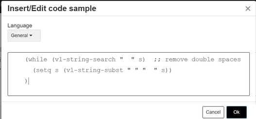

Ok, I figured out what the problem was with the pasted code in your message.
This CleanField function is missing the second space when you copy & pasted the code directly into the body of the message:
(while (vl-string-search " " s) ;; remove double spaces
(setq s (vl-string-subst " " " " s))
The better way to copy & paste code is to first click on this </> on the top bar of the message composition window:
Then paste the code into the popup window that appears:
Now the double spaces appear properly.
