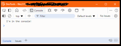

4) Run TEST command. Palette will open:
5) click inside palette somewhere to set it active. Then press F12 to open developer screen:
Best,
~DD

Antonin_JubaultSRF25
The "Dumb" work around works really nicely haha
