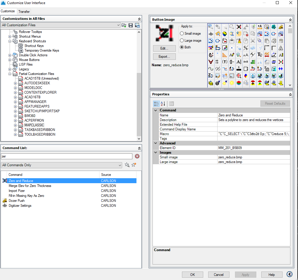

I have a macro already created for the command, I was just hoping to turn it into something that I could type out. For whatever reason, I work a lot faster when I can type commands as opposed to hunting for buttons. Is there a way to do that? Here's the macro for what I have:
^C^C_SELECT \^C^C3dto2d 0;p;;^C^Creduce 5;\;
One problem I have with the macro however is that I can only select one object at a time, and I have to reselect the object for the reduce part of the macro. Is there a way to set up selection sets in macros and then apply the selection set to multiple commands? Using "p" in the reduce part doesn't do anything because I guess you can't use that more than one time in a row? I'm not sure, like I said I'm pretty new at the whole customizing thing.

That would actually be pretty handy! I guess I missed that option when I was making the macro. Where do I assign the shortcut? My options in CUI when I made the macro were: name, description, extended help file, command display name, macro, and tags.

Message 11 of 49
I don't have "Custom" in my "Partial Customization Files" (step 4). I've attached what I see. The command that is highlighted in the command list and shown on the right side is the one I put together.
Message 12 of 49
