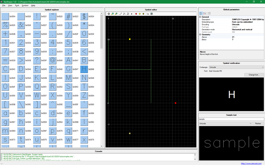

paullimapa
I found this free one called StarShapes which even lets you edit the shx:
Download page:
http://starcad.com/indexbdcf.html?q=en/node/4
It's the last one on the list.
