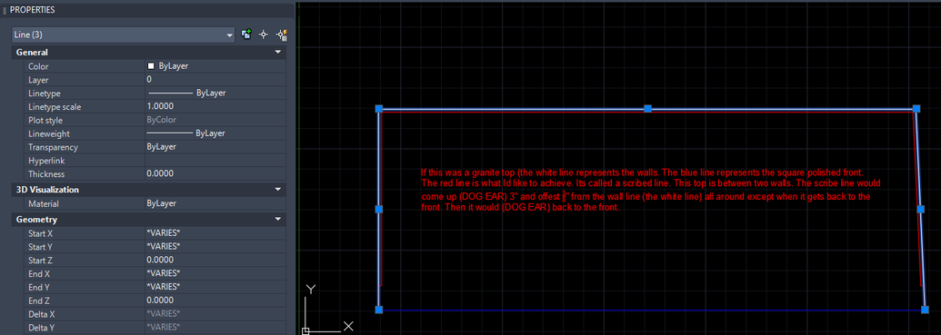

Do a screenshot showing what a scribed line is
Paul Li
IT Specialist
@The Office
Message 9 of 21
jsucheckiM6JVK
I'm not at my computer right now. Can I send you a dxf file of what I'm
looking to do later today?
Message 10 of 21
paullimapa
sure you can post that here when you're ready.

I see that the WHITE LINES are all individual segments.
If I did this manually I would:
First join them together as a single PLINE
Next OFFSET it 3/8" picking the side needed
Then go back and draw the dog ears TRIMMING the PLINE back 3"
Not sure how this can be done with lisp...perhaps @Sea-Haven might have a thought?

jsucheckiM6JVK
I've always done it manually by offsetting. I'd love to create commands that could do what I'm trying to accomplish. Example if one side ( left dog ear ) could be created then it could turn the white line red and create a new dog ear line that was scribed. I've seen other programs able to do this, just not seen it in autocad.
Message 16 of 21
jsucheckiM6JVK
In the program I've seen. Create one command called one dog ear. A rectangle you would click the one ear command, after you would select all the lines (lets say 3) you want offset the 3/8" then I would select the side I want it to start at. The last or end of the rectangle would have a 3/8 gap or opening.
