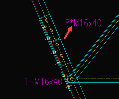

Dear Sir,
I have required text counting and sum.
2-M16x35
3-M16x45
2-M16x50
3-M16x55
2-M16x35
2-M16x40
2-PW16x6
Final Result
M16x35-4
M16x40-2
M16x45-3
M16x50-2
M16x55-3
PW16x6-2

ronjonp
@Gaganpatel wrote:
Dear Sir,
I agree difficult but please solve my post.
Give this a try. Not that difficult 🙂
(defun c:foo (/ _foo a i p r s)
  ;; RJP » 2023-05-01
  (defun _foo (str) (substr str 1 (vl-string-search "-" str)))
  (cond
    ((setq s (ssget "_X" '((0 . "TEXT") (1 . "*-*"))))
     (setq s (mapcar 'cadr (ssnamex s)))
     (setq s (vl-sort (mapcar 'vla-get-textstring (mapcar 'vlax-ename->vla-object s)) '>))
     (while (setq a (car s))
       (setq p (substr a (setq i (+ 2 (vl-string-search "-" a)))))
       (setq a (vl-remove-if-not '(lambda (x) (wcmatch x (strcat "*" p))) s))
       (setq r (cons (apply '+ (mapcar 'atoi (mapcar '_foo a))) r))
       ;; Print results to command line
       (princ (strcat "\n" p " - " (vl-princ-to-string (apply '+ (mapcar 'atoi (mapcar '_foo a))))))
       (foreach x a (setq s (vl-remove x s)))
     (princ (strcat "\n" (vl-princ-to-string (apply '+ r))))
     (textscr)
  (princ)
Result to command line:
Command: FOO
M16x55-16
M16x40-27
M16x45-8
PW16x8-1
PW16x6-1
PW16x5-1
PW16x4-1
PW16x10-1
You do have one callout that will not be tallied because it does not separate the number with a "-".

Gaganpatel
Dear Sir,
Sum Result in shown
I want to sum result text place in select location and sum result output in select object (After & Before)
Message 8 of 13
ronjonp
@Gaganpatel wrote:
Dear Sir,
Sum Result in shown
@Gaganpatel
Copy and paste from the command line into your drawing. It's still faster than your current process. 😎
I added the sum to the code above so try it again.
M16x55-16
M16x40-27
M16x45-8
PW16x8-1
PW16x6-1
PW16x5-1
PW16x4-1
PW16x10-1
56

Gaganpatel
Dear Sir,
Please see the After and Before example image
Message 11 of 13
ronjonp
@Gaganpatel You already have code to do what you're asking?
My code above will do the same as long as the quantity is separated by "-" then a description. The only difference is it prints the results to the command line.

komondormrex
hey,
check code below
(defun parse_text (text_ename)
	(setq text_string (cdr (assoc 1 (entget text_ename)))
  	      quantity (atoi (substr text_string 1 (setq minus_position (vl-string-position (ascii "-") text_string))))
	      item (substr text_string (+ 2 minus_position))
	(cons item quantity)
(defun c:calculate_items (/ text_sset assoc_result_list item_assoc_list_found item_assoc_list)
	(foreach text (setq text_sset (vl-remove-if 'listp (mapcar 'cadr (ssnamex (ssget '((0 . "text") (1 . "*-*")))))))
		(if (setq item_assoc_list_found (assoc (car (setq item_assoc_list (parse_text text))) assoc_result_list))
			(setq assoc_result_list (subst (cons (car item_assoc_list)
							     (+ (cdr item_assoc_list_found)
								(cdr item_assoc_list)
						       assoc_result_list
		  	(setq assoc_result_list (append assoc_result_list (list item_assoc_list)))
  	(setq assoc_result_list (vl-sort assoc_result_list '(lambda (item_1 item_2) (< (car item_1) (car item_2)))))
	(vla-put-height
	  	(vla-addmtext (vla-get-block (vla-get-activelayout (vla-get-activedocument (vlax-get-acad-object))))
	                      (vlax-3d-point (trans (getpoint "\nPick point for mtext placing") 1 0))
	                      0
		  	      (apply 'strcat (mapcar '(lambda (item) (strcat (car item)
									     "\t - "
									     (itoa (cdr item))
									     "\\P"
						      assoc_result_list
		(cdr (assoc 40 (entget (car text_sset))))
  	(princ)
Message 13 of 13
