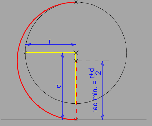

phanaem
the minimum radius is like this
Message 17 of 20

Message 18 of 20
marko_ribar
Yes, phanaem, that's correct... I've modified Gian's code to be applicable and for those kind of cases... This is what I use now...

            (setq rad_min (/ (+ (distance pcl c) cr) 2.0))
            (not
                (while
                    (progn
                        (setq rad (getreal (strcat "\nEnter Fillet Radius <min. = " (rtos rad_min) "> : ")))
                        (if (null rad) (setq rad rad_min))
                        (not (>= rad rad_min))

 HTH, just a little, M.R.
Marko Ribar, d.i.a. (graduated engineer of architecture)
