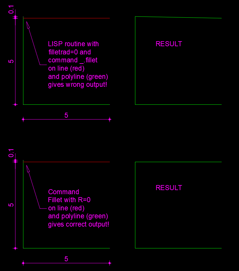

Strange behaviour LISP _.fillet with R=0 command (ACAD 2019 & 2022)
hreuvers
It seems AutoCAD has different definitions of the Fillet command.
The commandline Fillet gives a different output than the LISP Fillet. See image below and DWG attached.
Does anyone know how I can use/ address the *correct* Fillet definition in LISP?
You can see the difference in the command line:
Select first object or [uNdo/Polyline/Radius/Trim/mUltiple]: <= this definition gives wrong output
Select first object or [Undo/Polyline/Radius/Trim/Multiple]: <= this definition gives correct output

Are you trying to tell us something in your DWG file that is not mentioned in the words of your post?
Message 3 of 10
hreuvers
Yes, this strange behavior only arises when you have a large area with geometry in modelspace.
Therefore I have added this.
You can also add a "regen" command in the routine to overcome the strange behavior, but this is unwanted when dealing with large DWG's.

FILLET command, not using your lisp, seemed to work fine for me at the far end: but being very far from 0,00 is a known program limitation: if REGEN solved it then why not add that step in your automation if I may ask?

Hi pendian,
Thank you for your reply.
The example image I provided was done very close to the origin.
And yes, the commandline FILLET does the job correctly, anywhere. The LISP FILLET doesn't.
Currently we have included the REGEN in our routine, but it is not ideal.
The REGEN takes quite some time when dealing with large DWG files and lot's of Fillet R=0 operations.
We are using this routine since AutoCAD R14 without problems, I seems only last versions of AutoCAD are having this issue.
