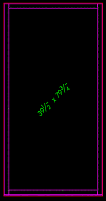

Fiddling around with this now and then, I arrived at the attached DimGlass45.lsp routine.  See comments at the top of the file.  Lightly tested.  For use only in orthogonal rectangular areas.
It does this in your sample drawing:
You just call the command and pick inside the glass area, which should have nothing else inside it.  It uses three Dimensions, the "x" in the middle being a separate one, so that the other two don't have any text override.
It uses some approximations for the shift off-middle for the text position of the other two, based on the number of characters [without fraction] and an assumed fraction sort of like another character whose size will vary.  Because there won't always be a fraction, it can get a little over-generous on the offset when there isn't:
but at least things should never overlap.  Maybe there's a more refined way of working out that positioning, with some deeper analysis of the size of the text content.
And it remembers current Layer and Dimension Style settings from when you start, as well as Osnap and command echoing and blips [if you use them] settings, and restores them all after.
