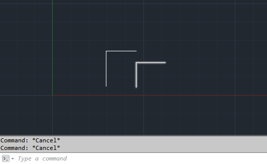

I found a LISP routine to lengthen multiple polylines at once by a set number. However, what I need is to shorten them by a set amount, and this routine isn't working right with a negative delta. If the last line segment in the polyline is shorter than the trim amount, it reverses that line - in other words, it draws a new segment going backwards from the vertex, instead of trimming the next segment.
Attaching a file to illustrate the issue. The first polyline is the original. The second is the desired result (the result of using LENGTHEN). The third is what happens with this routine.
Does anyone have a fix? I need to trim hundreds of polylines by a fixed amount on each end and I don't want to do it manually. If there is a different command that might work, I'm all ears.

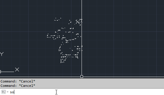

This works great except ... it's changing some setting I can't figure out, I think. The lines trim, but then if I try to select them to copy them, they don't select. They LOOK selected, but I can't copy them or modify their properties.
I might be able to find a workaround, but if you have any idea what the setting issue might be, please let me know. Thanks!

Ranjit_Singh
@Anonymous wrote:
This works great except ... it's changing some setting I can't figure out...........
I am not changing any variables. Not sure what is happening. Can you post your command output. It will help to understand the problem.post_command_output.gif

Note that I changed the name of the routine and added explanatory text because this may be used by other people in my office, but I didn't change anything else.
I'm also attaching the file with the edited polylines in it ... they behave strangely and I'm unable to move them to a different layer.

Getting rid of the isolateobjects and unisolateobjects fixes the problem.
