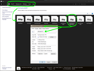

The actual TTF file is most likely not called that, why not go here C:\Windows\Fonts to find it, right-click to select PROPERTIES and see what the TTF file name is actually called, see if that helps.
For example
