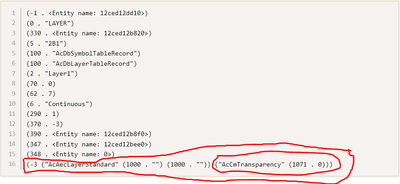

Is it possible, tat I can not directly Set the property Transparency when I generate new layers but have to create my layer first and change  the Transparency later?
Tried with
(CREATE-LAYER "Gebäude_Schraffur" '((COLOR . 253) (DESCRIPTION . "01211F") (LINETYPE . "Continuous") (LINEWEIGHT . "20") (TRANSPARENCY . "50")))
And got a Message that Transparency was unknown

layer transparency has to be set via extended data.

If you just use an ordinary LAYER command in an AutoLisp (command) function, instead of a specialty routine, it's easy, and does not require going into extended data:
(command "_.layer" "_make" "Gebäude_Schraffur" "_color" 253 "" "_description" "01211F" "Gebäude_Schraffur" "_lweight" 20 "" "_transparency" 50 "" "")
Oddly, the default-on-Enter Layer application in the Description option is not to just the current Layer as with most options, but to all Layers, so it's necessary to spell out the Layer name again for that.
The numerical entries do not need to be as text strings.
It is not necessary to assign Continuous linetype to a new Layer -- that is the default.
[Also, I spelled out the option names in full, but if you use the abbreviations, it takes less code than the specialty (CREATE-LAYER) function needs.]

funny thing, but the layer transparency could be set beyond 90% limit using xdata.
