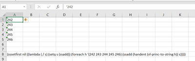

hey there,
generation of a lisp expression to copy from the excel to paste to the autocad command line to select objects by theirs handles. based on @ВeekeeCZ lambda.
komondormrex_0-1735501165165.pngkomondormrex_1-1735501207685.pngkomondormrex_2-1735501241836.png

Sea-Haven
@komondormrex great idea just let Excel do the work, did you do a bit of VBA macro so read selection and convert to a single multi value string? Then make the string to be copied.
Threw the question at Copilot and got some really useful starting code and made some changes to it.
