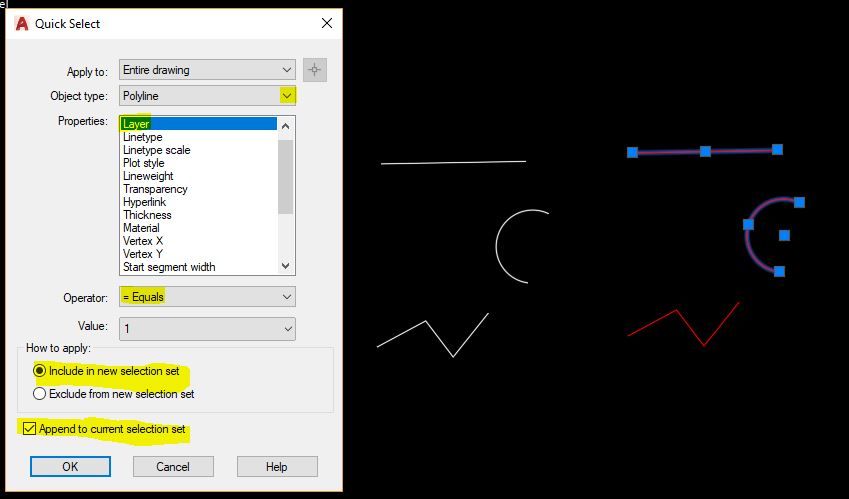

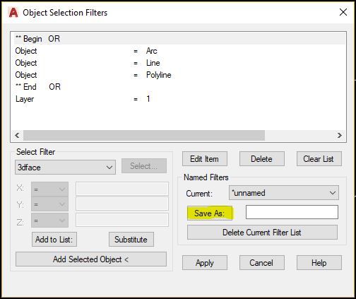

3wood
Firstly, you can make SELECTSIMILAR work. There is a setting option in SELECTSIMILAR command.
Capture2.JPGYou can select
Secondly, you can use QSELECT.
QSELECT:
Thirdly, you can also use FILTER.
FILTER:
 You can save the filter and use it in other drawings.
QSELECT:
FILTER:
Hi @3wood
Qselect isn't working as I expected.
Very nice Filter command, I hadn't ever used it. But isn't working too.
 It isn't select any object. Smiley Frustrated

cadffm
Filter:
Because no Object is a arc a line and a polyline at the same time 😉
beginn OR
object = line
object = arc
object=polyline
end OR
layer=mylayer
[apply]
ALL<enter><enter>
Sebastian

Kent1Cooper
The SELECTSIMILAR approach with the options checked would require finding all Lines with one selection, all Polylines with another, etc. -- it won't find different entity types together.
The QSELECT approach filtering by Layer will also find any things other than the desired entity types [Splines, Text, Viewports, ...] that may be on that Layer.
I like the FILTER approach best of those suggestions for those reasons, but it also has the small disadvantage that you still have to Select [either before calling up FILTER or after hitting Apply] the range of stuff from which you want it to filter out those objects -- not too difficult to not pre-select and just type ALL after hitting Apply, but still....  The AutoLisp routine finds them all without that, immediately upon calling it.
SELECTSIMILAR runs perfectly in my AutoCAD 2017. Just select 1 line, 1 arc, and 1 polyline in one go (them can be in different layers) and SELECTSIMILAR finds out the rest for you.
When you are using QSELECT, you need repeat it a few times and tick"Append to current selection set" option to append different objects into previous selection set.

3wood
You need copy exactly what's shown in my FILTER screenshot and only change the layer name to yours.
