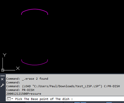

paullimapa
@arunkumar_selvarajan after @Kent1Cooper correction I'd get this message which means it never runs the key part of the code:

now when the PR-DISH starts it's prompting for Base point of dish
where should this be?
Paul Li
IT Specialist
@The Office
Message 32 of 34
paullimapa
Ok, I got it to work. I just selected 0,0 as the base point of the dish (which can be actually anywhere on the screen).
Then I had to change in the section of the PEDIT line of your code:
1) I have to first do a ZOOM Extent so that the LINE selected with pt13 can be recognized by the PEDIT command
2) Then I changed the coordinate from pt18 to pt19 to successfully get a crossing selection
So change this:
(command "pedit" pt13 ""  "j" "c" pt18 pt32 "" "")
To these lines:
  (command "_.Zoom" "_E")
  (command "_.Pedit" pt13 ""  "_J" "_C" pt19 pt32 "" "")
Then it works and ends requesting for rotation:
FYI, the code also fails if you don't have those Layers "1" and "7" already created since your code only Sets to them but does not check to see if they exists first...
You may want to use the Layer Make option which will create the Layer if it doesn't exists and then automatically Sets that as the current Layer.
So replace these lines:
(command "-layer" "s" "1" "")
(command "-layer" "s" "7" "")
With these lines:
(command "-layer" "_M" "1" "")
(command "-layer" "_M" "7" "")
Lastly, when PEDITACCEPT is set to 1 instead of 0 this causes error messages to fly across the command line.
But the PR-DISH command will still complete successfully.
