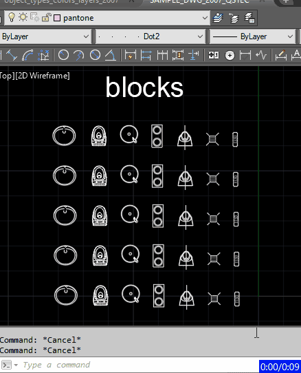

Maybe this will interrest you too. The lisp filters the selection and the user can select what blocks he is looking for. It also works with dynamic blocks.
It is available to download from >my website< or from the >Autodesk App store<.
