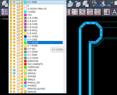

Kent1Cooper
I always use the pull-down in the Layer area of the ribbon:
BUT be aware that what appears in that pull-down list is determined by the Filters setting in the Layer Manager.  Pick on the Layer Properties box at left above, and in the Layer Manager, check the Filters:
Depending on the drawing, you get different choices, always including All and All Used Layers as shown, or if there are Xrefs, All non-Xref Layers is an option, etc.  The same filtering is applied to the pull-down in the ribbon.

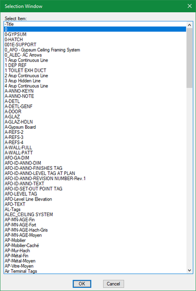

paullimapa
try this lisp using dcl
(load "DDCHL")
DDCHL
 Then select objects
list box appears
hit letter on the keyboard to jump to the first letter of layer name
you can double click a layer to complete selection

paullimapa
I like this very simple one and a major plus that the dialog box is stretchable.
Too bad there's no setting to filter out certain layers from the list like DEFPOINTS

fernando_ortizmn
It works great.
You could only view the layer filter currently in use and not see unnecessary layers.
I'm still very grateful to both of you for your support.
