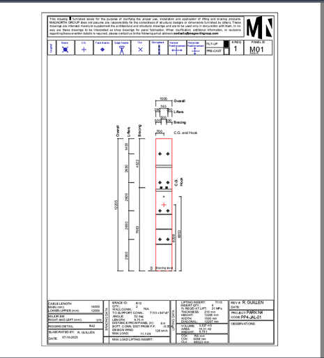

Dear Autodesk Team,
I hope this message finds you well. I am encountering the following issue when printing in AutoCAD.
I work with several files that contain a template, which is repeated N times within the Model space. This template is used to record information for the Tilt-Up wall shop tickets. Each template instance contains the specific information of one wall from the project.
The problem arises when I need to print all of these templates. Currently, I must print each one individually, which takes several hours when there are many walls (sometimes more than 400). On average, it takes about 20 seconds to print one wall to PDF.
I would like to suggest that AutoCAD include a function that can automatically detect all instances of a given template within the Model space and print each instance on a separate sheet. This would significantly reduce printing time and allow me to perform other tasks while the batch printing is running.

@renny_guillen Your use of the word "template" does not match AutoCAD usage: it appears your CAD file (thanks for sharing BTW) does not take advantage of layouts, a built-in tool do to exactly what you want as long as you take the time to create a true AutoCAD-defined "TEMPLATE" to start all of your drawings in.
May I ask if you all avoid using layouts to meet your exact batch publishing needs? Or do you need an introduction and some tutorials on the topic?
OR... you can create VIEWs for each (VIEW command), then Automate with LISP or a SCRIPT to print each view.
Or use those create VIEWs to set up Layouts to then PUBLISH as well.
You just need a small workflow change to achieve what you need in AutoCAD. Nothing more.

Like the others there is no way to work out the area of each page. If you put either a title block or a border around the area of interest at a size that matches a scale for your plotted sheet then you would have had an answer straight away. Look at the green boxes they are a A4 sheet at a true scale to suit your dwg. So update your dwg then the correct answer can be provided many of us have an answer already done. Layouts or Model ?
Using layouts is a much better way you make a layout with the correct title block, at true 1:1 size say a A4, just copy the layout and move along in the viewport, you can set the screen midpoint and the scale of the dwg, "zoom 0.1XP"
Image is a layout at 1:100 A4 border matches the green boxes in model space.

The attached lisp function pltpln.lsp uses the following assumptions to automate the plotting of all 85 sheets in sample "Tilt-Up7Prueba.dwg"
1) The border for each sheet is made up of a rectangular pline with area = 673420293.7
2) PDF sheet size = A4
3) Scale = Fit
4) Pen Assignment = Monochrome.ctb
5) Plot file name = Tilt-Up7Prueba-M##.pdf

Ok a big problem you have set your title block up as a A4 sheet, but every printer has what is knowm as "hard clip limits", for a A1 Plotter the clip is quite big like 20mm on an edge, for a laser printer most use say 6mm so that means your title block should be 285x198 or factor up by 1000 etc. so if you make this subtle change to your title block then as @paullimapa has commented your sheets should then plot correct.
Can the title block be just that, a block rather than lots of text and lines. Also if using the outer box it is currently on layer "0" it would be way better to have it on a separate layer so that layer can be found and the correct window plotted. If the title is a block you can find all of them by name.
Can you maybe have another go if the Tilt Panel software will let you do what has been suggested. A really good answer is so close.
