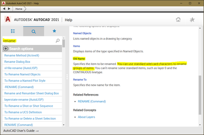

Assuming you want to change all names that begin with "DS-301-145..." to "DS-302-146..." (for example), select one of the names that has that common beginning string, so that its name appears in the upper name field. Now, edit the string to replace everything that follows the characters you want to change with an asterisk ("*"). Now all of the block names that match up to that character will be highlighted in the listing. Now enter what you want that string to read in the lower name field (again using the asterisk) and hit the button.
Of course, it's important to understand that this method works only with names that follow similar patterns. And sometimes the renaming has to be done in logical steps. Your example seemed to be that, so I thought you might benefit from learning about this time-saving technique.

I'm having the same issue. I've exported several cad files from revit, and every block has "-_3D - [my name]_" at the end of the block name. I would like to retain each block's name but without my name on the end. I was able to use the wildcard * along with the text I would like to remove for the block names, but I can't figure out how to remove that portion of the names without going line by line which would take days.

Be sure to include a small portion of the block name that you want to remain after the asterisk, like so:
find: *-_3D - warren_clements_
replace: *-_3D
(Everything that ends with this, I want it to end with this.)

I keep trying that exact text, and it runs through the names like its going to replace/remove the text but it doesn't. Thanks for the quick response.

Please post a screenshot of the Rename dialog with your entries in each field.

See attached. It will select all of the matching text as if it plans to replace.

If all of the block names that match the criteria do not become highlighted in the list, then there must be something different in the criteria you've entered.
Try starting smaller and then building up... and hopefully you'll see where the difference is.

That's what I was trying to say. It will select all of the text, and when I click rename all of the text is re-selected.

It appears I've been wrong about how this works, because I just tried something similar in one of my DWGs and it does the same thing you report. I could've sworn I've done this before (but apparently not).
I apologize for misleading you.
I think your only other option may be to use strings of ????... of various lengths as stand-ins for the segments you want to retain in blocknames with similar lengths and suffixes. (This doesn't seem like it will be much of a time-saver, though.)
