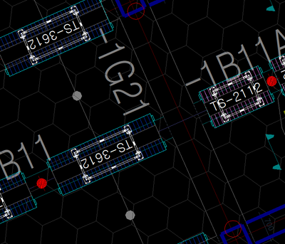

The reason behind why I wanted to create a line and delete it was because I wanted to see a physical line reference when I select two points. Like you said there is no need to make a line, but it was just a personal preference. If I don't have creating line function, then it doesn't show the distance of two points during the selection but rather shows x,y coordinates (Pic1). If there is another way to do show distance of two selected point during selection, I would be open to it. Before I had to measure the distance then find a block to fit that distance. This is why I wanted to show distance during the selection process of two points.
Initially I wrote a code with just selecting two points, placing a block, then explode. This worked perfectly fine until I decided to add creating line function. I kinda understand about jumping through the hoops to get around limitation, but that might cause a problem later on if I decide to add more functions to the code. I think possibility you are referring to about "reverse the deleting of the line" is true. Below is the code that worked before without the line but I would be open to more suggestions.

If you have Coordinates display turned on in the status bar, and set to the right display option [relative displacement], then if you give the first point as a reference in the (getpoint) function for setting the second point, you will see a "rubber band" in the drawing area from the first point to the cursor location, and the distance and angle of the displacement between them in the status bar, as you move the cursor around to pick the second point:
(setq startPoint (getpoint "\nSelect first point: "))
(setq endPoint (getpoint startPoint "\nSelect second point: "))
