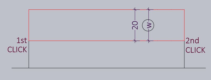

Hey anybody can help me please.
Make rectangle with specific width.the lisp may work like this.
rw
width?
specify first point
specify second point
395 Views
1 Reply
Reply (1)
ВeekeeCZ
Hi... you may this one:
