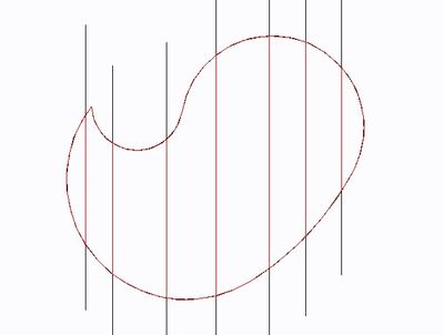

Is there anyone with a command that can make a rectangle extend to a polyline/line?

Kent1Cooper
Some potential complications that will need to be accounted for, if such variations in relationships might occur:
In the situation on the left, the red rectangle would need to be stretched so that its left  edge meets both  the upper and lower boundary edges.  But in the situation in the middle, the left  rectangle edge would need to reach the top  boundary edge, but the right  rectangle edge would need to meet the bottom  boundary edge.
Would you ever have a situation such as on the right?  The routine by @hak_vz [so far] uses the extension of a single Line to find virtual intersections with the boundary, but it only allows for there being two  such intersections.  In this situation there are four  virtual intersections, so some way would need to be found to determine which are the correct ones to use.
Not that all of these things couldn't be accomplished, presumably with a whole lot of comparisons of distances between points, but it's complicated....

devitg
Understood.
If I would make that question , I would say  .
I'm looking for a so named NESTING.
In this case my blank material is 10 units wide, by whatever length,  and I need to have listed, or saved to a CSV file as to order cutting pieces at the workshop.
Area to cover could be any from, and BLANK material could be vertical, or horizontal , according to needs.
For better understanding refer to attached DWG .
 Please do not doubt to ask for further information.

Here is updated code that that extends rectangle in any direction, and overlaps with boundary object. In case of complex boundary some manual trimming will be needed.Basic rectangle is lost and new is created from line objects so joining is needed, and placing them to appropriate layer ....  If it works for you, select this as a final solution!

Upper code now extends both rectangle sides and looks for maximum distance to boundary  (@Kent1Cooper message 24). To avoid too much testing it creates two overlaping rectangles, converts them to regions and create its union. That region is exploded and resulting lines are joined into a new rectangle.

Sorry for the delayed response, and thanks to everyone who has contributed to this lisp. I've done some heavy testing with this lisp and it works great except for the three examples i have attached. The first image on the top left hand side goes completely through the rectangle, would it be possible to tell the rectangle to stop at the first intersection if desired and if not click the rectangle again to make it extend to the next intersection point? Second image on the top right hand side, is a similar problem to the first. I started on the bottom side of the polygon and when i ran the lisp it flipped to the other side. The third problem is the rectangle didn't extend to cover the entire area (the first rectangle from the left) is there a way to make it cover the entire area?
Message 31 of 44
hak_vz
@Anonymous wrote:
hak_vz
Case 1 ) Create a line that goes across both objects, then use command "boundary" or shortly "bo" to create two separate temporary areas and then use command on this new objects. This are two separate object and we have to make them part of a single boundary that has a smooth and uninterrupted "flow" (upper right case)
Case 2) Apply same logic and separate shape to two areas (two rectangles)
Case 3) Huh, maybe but would need complex logic. Simpler solution is just to pedit extended rectangle and insert a vertex (pedit -> edit vertexes -> next or insert)
To have all this cases solved in a code one would have to apply a lots of logical thinking.
Generally in this forum you'll receive a decent solution but don't expect that someone will bother with it if solution is to complex. To override problem with finding stretch to cover whole boundary I've applied a solution that just crossed my mind (using regions and union) and it just worked. Otherwise I would not bother with complex mathematics. But luckily for you it works, at least for some cases. You may place your starting rectangles inside, or even outside, so some interesting results may happen. I'll try to update code so that it accepts more than one shapes as a boundary, but not before weekend.

As I have written in my previous post solution to situations you showed is to split complex object or an shape that consists from more then one boundary object is to split it to simple subareas and then applying code to those subareas, as showed in attached images. Complex shape with square hole inside has been divided in subareas (magenta). In case where original boundary doesn't satisfy correct rectangle extension (number of intersection greater then two) use subdivided areas created using command boundary or just a simple rectangle. For uncovered edges use pedit -> edit vertexes -> insert vertex and add one or more vertexes . Adding into algorithm additional boundaries and special cases to handle would make code to complex and additional problems my emerge. But, as I stated in one other post "Autocad is preliminarily a drafting software" so running code more then once shouldn't be a problem".
Here is updated code that handles region creation better without polluting console and has updated undo handling-
Select this code as a final solution (drop down menu -> rectangle aside with three dots)
