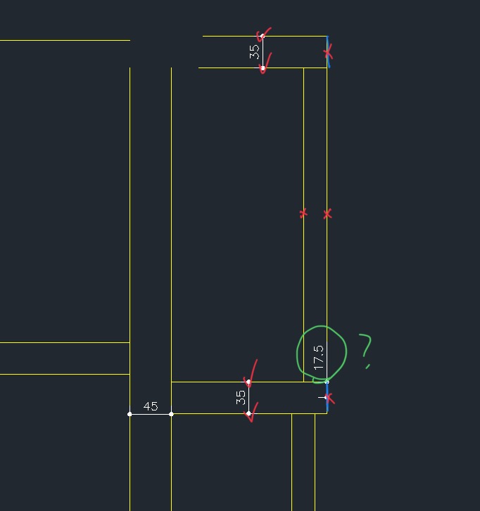

Message 5 of 20
Thanks for your lisp.It works great but has some bugs like picture below.Is there any solution to fix this question?
This is my dwg file.
Message 6 of 20
ВeekeeCZ
Well, as matter of fact, all issues are caused by drawing flaws or violations against presuppositions. I've marked them in your drawing. Once there is some issue, it spreads like an infection to the surrounding area. One issue can cause 10 others. So for that matter I've added a maximum diameter limit, to skip the issue and stop spreading.
Also could be an issue if more pips are parallel (or just close) and some of them has diameter >= wall distance.
And of course, the routine works with LINEs only, not polylines.
That's all I can do. Read (at least) the notes in code, they will help you understand the algorithm. It's not magic.
HTH

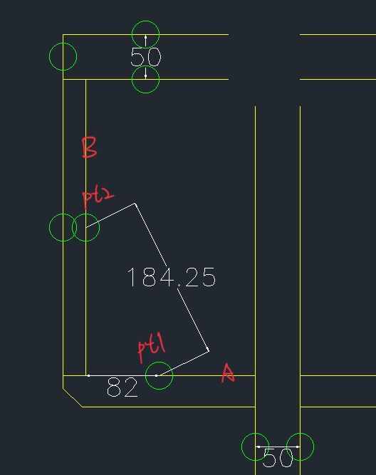

I test a dwg file(try.dwg is below) and found some questions. In Q1.(picture below) I marked the midpoints for each lines.Limit I set 100. I don't understand that why 17.5 this label be produced,but the parallel lines don't have dim. In Q2. the minimum distance is 25,but the parallel lines don't have dim and appears 81.9996 larger distance.These questions are not the same as the  code's logic I understand.Please let me know where the problem is.
THX

I have a better understanding of code logic,but I still have some questions to ask you.First, you said it is first to all,so all the lines are paired in pairs according to the system’s own order?
Q01. distance between pt1 to pt2 is 184.25. Limit I set 100,it shouldn't be found pt2 in theory.I wonder if it is the distance from point to line instead of point to point?
Q02.up and down 35 width lines have been dimmed,those lines are removed based on your code.But I don't know why 17.5 will be appeared, the line on 35 width upper line should be removed.If the distance from the midpoint of line B exceeds the limit.
That's my questions.Please tell me if  I do not understand the code's problem or other problems.THX
Message 11 of 20
ВeekeeCZ
I see, good catch! Thanks. It was my bad.
The thing is that once we found the closest line (by min mid-mid dist) we put DIMALG from mid of first one to the CLOSEST point of the second line, so we can perpendicularly dim a diameter. Which was good...
...if I haven't used this mid-closestpoint dist for the limit condition. It should be mid-mid dist.
I guess it would solve both issues.
