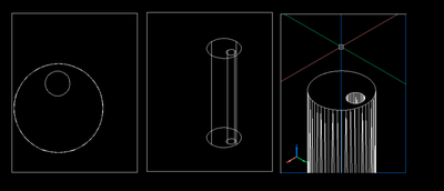

This is what I'm going for. I have a CSV file of points that I would like to eventually draw circles at the points and then loft the circles from the points that coincide with one another.
Message 12 of 25
Kent1Cooper

No, the CSV file would have hundreds of points, but each point would have a "pair" and that's where the circles and lofting would occur. Yes, all the circles will be the same radius.
I've attached a test CSV file of what it would be like. the .1 would be the partner point. ex. 100 and 100.1 would be together. We can always change the point name if needed. Also apologies I thought I recalled it being xyz and instead it is yxz.
