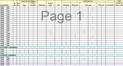

In order for me to create a drawing list for a project, I currently need to open each drawing up, and look at the attributes within the title block and then copy the drawing number, the sheet number, and the revision number into a row within the drawing list and then define which group within the company receives a copy of that drawing. All the "1" next to each drawing type are standard, so 01D's always gets sent to those specific groups, and so fourth.  I know the basics of programming within AutoCAD, but is anyone able to create a program that pulls this data from the title block and then places that information within a row on the drawing list? I have attached an excel drawing list and a couple dwg's to play-around with.

I have make a dwg index for a single dwg, but as your using multiple dwgs and reading attributes from different dwg's you need to use OBDX, it allows you to read information even from dwg's not open.
You have provided 2 sample dwg's with only a single title block in each dwg. Do you use layouts ? Looking at the Xl you have a lot of sheets are every one of these a separate individual dwg ? The easy part is reading a known block name.
Please explain more how your dwg's are set up.

Yes, every Title blocks block name will be that TAD 15, and each block contains the same attributes. All the sheets are there own individual dwg, so 01D SH 1 and 01D SH 2 are 2 completely separate drawings. That excel file is an example of what a drawing list might look like, but that's one specific project. Every project is going to have different drawing names, for each site but follow the basic convention of how we call our drawings outs. We do 99.99% of our work in model space. We don't use any of the other layouts to draft/design and never work in paper space! I have included some more dwg's as well as another example of a drawing list from a previous project for some more understanding! @Sea-Haven

Just to let you know still working on it, but getting somewhere using OBDX. Found a way to get the block from model space, it may not be fast but is faster than say use a script and open dwgs.
Please try this it should make a big list of all the attributes tagname and value. You just need to pick any dwg in the directory you want to look in. Dont need dwg's open that is why using OBDX which can read closed dwg's.

Next step is write to EXCEL I don't have a problem with that just need to work out what goes where. can you do a Excel matching the 4 dwgs provided ?

@Sea-Haven I Apologize! I didn't see your previous response. Here would be an example of a drawing list using the above 4 DWG's. The Site ID's would be in numerical order, starting with the smallest Site ID and the smallest drawing series, S021-01E SH 1 Rev 29, and then increasing in each category. So S021-20D would come next, S271 -01D SH 1 after that, etc... Let me know if you need anything additional!
