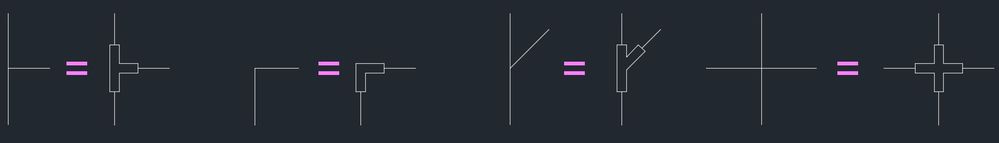

Hi all,
Hard to describe in words what I'm trying to do. So here is an image.

DC-MWA
Here is the image.
I have tried blocks, but it becomes tedious.
If the lisp would 1. ask user to select the intersection, 2. then draw and trim as shown in image parametrically..

DC-MWA
The dimensions would always be 1/4" long from intersection x 1/8" wide ( 1/16" from line). These numbers would by multiplied by the current dimscale....
See image to clarify

How about this approach:
-select lines
-find intersections
-draw a rectangle for each line (representing the fitting outline)
-region the rectangles
-break the lines at the point of intersection and at the point where the fitting ends
That should leave you with a region. If you want it to be a polyline, you can explode the region and join the remaining lines.

DC-MWA
Ok,
I have the angled rectangle by two clicks (midpoints) figured out.
I have LINEWORKSHRINKWRAP to draw boundary around the rectangles after drawing.
Then erase the rectangles.
I now need to figure out the intersection point and each line direction from picking the intersection?

If you are offering software solutions to clients, you should at least try and improve your lisp skills. The function you want to create is almost trivial /basic 2D geometric functions/. Here is a starting point for you /barely tested/.
(defun c:test ( / DrawRect line1 line2 len width fuzz line1Start line1End line2Start line2End intersPt line1Ang line2Ang p1 p2 p3 p4)
(defun DrawRect (lst)
(entmake (append (list (cons 0 "LWPOLYLINE")
(cons 100 "AcDbEntity")
(cons 100 "AcDbPolyline")
(cons 90 (length lst))
(cons 70 1))
(mapcar (function (lambda (p) (cons 10 p))) lst)))
);defun
(while (not line1) (setq line1 (entsel "\nPick first line: ")))
(while (not line2) (setq line2 (entsel "\nPick second line: ")))
(setq len 80)
(setq width 20)
(setq fuzz 0.01)
(setq line1Start (cdr (assoc 10 (entget (car line1)))))
(setq line1End (cdr (assoc 11 (entget (car line1)))))
(setq line2Start (cdr (assoc 10 (entget (car line2)))))
(setq line2End (cdr (assoc 11 (entget (car line2)))))
;If the 2 lines intersect
(if (setq intersPt (inters line1Start line1End line2Start line2End))
(progn
(setq line1Ang (angle line1Start line1End))
(setq line2Ang (angle line2Start line2End))
(mapcar '(lambda (line / lineStart lineEnd lineAng)
(setq lineStart (car line) lineEnd (cadr line) lineAng (caddr line))
(cond
;Intersection point is on the start point of the line
((equal intersPt lineStart fuzz)
(setq p1 (polar intersPt (- lineAng (/ pi 2)) (/ width 2)))
(setq p2 (polar (polar intersPt lineAng len) (- lineAng (/ pi 2)) (/ width 2)))
(setq p3 (polar (polar intersPt lineAng len) (+ lineAng (/ pi 2)) (/ width 2)))
(setq p4 (polar intersPt (+ lineAng (/ pi 2)) (/ width 2)))
(DrawRect (list p1 p2 p3 p4))
;Intersection point is on the end point of the line
((equal intersPt lineEnd fuzz)
(setq p2 (polar (polar intersPt (+ lineAng pi) len) (- lineAng (/ pi 2)) (/ width 2)))
(setq p3 (polar (polar intersPt (+ lineAng pi) len) (+ lineAng (/ pi 2)) (/ width 2)))
;Intersection point is in the middle of the line
(T
(setq p1 (polar (polar intersPt lineAng len) (- lineAng (/ pi 2)) (/ width 2)))
(setq p4 (polar (polar intersPt lineAng len) (+ lineAng (/ pi 2)) (/ width 2)))
);cond
(list (list line1Start line1End line1Ang) (list line2Start line2End line2Ang))
);mapcar
(princ)
);defun
If you spend some time, im sure this can be written in a far more elegant way, in probably less than half the code.

DC-MWA
Your code works but I ran into a couple things.
What if I have more than two lines? Corners are problematic as well.
