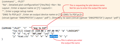

@Jonathan3891 If you don't mind....I'm working through one of these, what part of your lisp tells the routine to ignore overwriting an existing pdf?  I have a simple routine the plots only specific named layouts but hangs when there is an existing file.
(defun C:RRR ( / cmd)
(setq cmd (getvar 'cmdecho)) (setvar 'cmdecho 0)
(foreach Layout (List "Cover Page" "Demo")
(command "_.-PLOT"
"No" ; Detailed plot configuration? [Yes/No] <No>: No
Layout ; Enter a layout name or [?] <Layout1>:
"" ; Enter a page setup name
"DWG To PDF.pc3" ; Enter an output device name or [?] <DWG To PDF.pc3>:
(strcat (getvar "DWGPREFIX") Layout ".pdf") ; Directory to save (strcat (getvar "DWGPREFIX") Layout ".pdf")
"No" ; save changes to page setup?
"Yes" ; proceed with plot?
); command
); foreach
(setvar 'cmdecho cmd)
(princ)
Message 15 of 32
paullimapa
review the plot sequence of commands very carefully and you're see where your error is:
Paul Li
IT Specialist
@The Office
Message 16 of 32
ec-cad
If it is stopping because the .dxf file exists, you need to either 'delete' the .dxf, or check if it exists.
Here's a sample route to check if it exists. It's up to you to 'delete' it if you are updating it.
You could use (vl-delete fname) if updating.

wow.  Thanks guys for the responses.  I got two completely different directions here.  @paullimapa the routine works with the correct file/layout names.  It just errors when the file exists so I'm not sure to look for my mistake.
@ec-cad I loaded your routine and if the file does exist, if just does nothing, Maybe a message that says file exists, do you want to overwrite?  I have no clue how to do that.  I was hoping it would just be a Y/N in the command string somewhere.

Curious as to what version of AutoCAD you're using. In older versions I've notice the PLOT sequence may not work if the output file exists. I would have to code in a sequence to check and delete the existing output file name.
I've tested in 2020 through 2025 and now the plot sequence actually automatically overwrites existing matching output file names. Your existing C:RRR code works flawlessly as long as you do have layout names matching "Cover Page" and "Demo".
So I'm not sure if your problem relates to current versions of AutoCAD. But I've included the sections of code that would do the check and delete the matching output file in your system. Hopefully you have permissions to delete and make sure the PDF file is NOT currently opened by any viewer:
