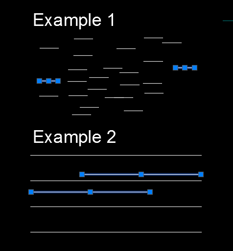

I need to find the outermost lines (example: red lines in the snapshot below )from a bunch of lines. Any help in this regards will be highly appreciated. Thanks.

In most of the cases, the lines will be parallel, either vertical, horizontal or aligned. My posted snapshot was an extreme case. The angular difference would not be more. Lines will never intersect with each other, but their sizes will vary.
Sorting by the X coordinate of their midpoints would give the answer if the lines were horizontal. Sorting by the Y coordinate of their midpoints would give the answer if the lines were vertical.
But here the issue is, the lines may be aligned, and their sizes may be different as shown in my snapshot.

Your method works only for parallel lines.
In OP, the lines are not quite parallel and, in some condition, your average angle is wrong. See the result of your function.
In the image, some angles are almost 0 or pi. The green line is from p1 to p2 and the red lines are from mid to ip1 or ip2.
Your sorting method is ok, but the average angle is not.
Of course, any attempt must assume parallel lines or almost parallel.
This is my offer, pretty much the same. The average angle is better approximated and the sorting method uses trans instead of distance.

The problem is with the angles near 0 (or 2pi) and near pi.
You can have these almost horizontal lines: 1°, 359°, 181° and 179°. Your angs list will be (1 179 1 179) with an average of 90 deg.

It's not that. The average angle must approximate the orientation of all lines. Obviously, the Green line in my image is not.
Your lisp is checking the distances on a "perpendicular" line, which is as hard to find as the average angle. Try your lisp on a bunch of perfectly horizontal lines.
Finding the average angle is the key. Then you can apply John's code, or you can use a +-90deg angle and apply your code.
The average angle is quite a challenge. I thought I had it but it didn't work. Now I have this new version but I'm not sure is foolproof.

    (setq anglst (cdr anglst))
    (setq pl (cons (list (abs (sin a)) (cos a)) pl))
  (setq p (list (/ (apply (function +) (mapcar (function car) pl)) (length pl)) (/ (apply (function +) (mapcar (function cadr) pl)) (length pl))))
  (if (equal p (list 0.0 0.0) 0.05)
    0.0
    (atan (car p) (cadr p))
;(avgang (list (+ 0.0 (/ pi 100)) (- (* 2 pi) (/ pi 100)) (+ pi (/ pi 100)) (- pi (/ pi 100))))
; passed as 0.0
;(avgang (list (+ (/ pi 2) (/ pi 100)) (- (/ pi 2) (/ pi 100)) (+ (* 1.5 pi) (/ pi 100)) (- (* 1.5 pi) (/ pi 100))))
; passed as 1.5708
And in John's code :
(defun c:outermost ( / 2d midp avg avgang ss i e ent ents p1 p2 ang angs mids mid ip1 ip2 d1 d2 d1min d2min outer1 outer2)
  (defun 2d (p)(list (car p)(cadr p)))
  (defun midp (p1 p2)(mapcar '* '(0.5 0.5)(mapcar '+ p1 p2)))
  (defun avg (nums)(/ (apply '+ nums)(length nums)))
  (defun avgang (anglst / a pl p)
    (while (setq a (car anglst))
      0.0
  (and
    (setq ss (ssget '((0 . "LINE"))))
    (repeat (setq i (sslength ss))
      (setq ent (entget (setq e (ssname ss (setq i (1- i))))))
      (setq p1 (2d (cdr (assoc 10 ent))) p2 (2d (cdr (assoc 11 ent))))
      (setq ents (cons (list e p1 p2) ents))
      (setq ang (angle p1 p2))
      (setq angs (cons ang angs))
      (setq mids (cons (midp p1 p2) mids))
    (setq mid (list (avg (mapcar 'car mids))(avg (mapcar 'cadr mids))))
    (setq ang (avgang angs))
    (setq p1 (polar mid (+ ang pi) 1e6) p2 (polar mid ang 1e6))
    (foreach ent ents
      (setq mid (apply 'midp (cdr ent)))
      (and
        (setq ip1 (inters mid (polar mid (+ ang (* pi 0.5)) 1e8) p1 p2 nil))
        (setq d1 (distance p1 ip1))
        (or (not d1min)(< d1 d1min))
        (setq d1min d1 outer1 (car ent))
      (and
        (setq ip2 (inters mid (polar mid (+ ang (* pi 1.5)) 1e8) p1 p2 nil))
        (setq d2 (distance p2 ip2))
        (or (not d2min)(< d2 d2min))
        (setq d2min d2 outer2 (car ent))
  (cond
    ((and outer1 outer2)
      (sssetfirst (ssadd outer1 (ssadd outer2)))
    (outer1 (sssetfirst (ssadd outer1)))
    (outer2 (sssetfirst (ssadd outer2)))
  (princ)
Regards for now...

Message 17 of 26
john.uhden
Marko:
Both you and @phanaem are correct.  The average angle is the key.  I think that the OP mentioned that all the lines are almost parallel, so that means I want to adjust the angles so they are in the general direction as any one of the lines, let's say the first in the selection set, then take the average (watching out for angles hovering around 0 being the same a 2pi).
BTW, your version produced only one outermost line.
I'll be back.
John F. Uhden
Message 18 of 26
john.uhden
Following my own advice, this one works much better.
(defun c:outermost ( / 2d midp avg ss i e ent ents p1 p2 ang ang1 angs
                       mids mid ip1 ip2 d1 d2 d1max d2max outer1 outer2)
  (and
      (if (< (abs (rem ang (* 2 pi)))(/ pi 10)) ;; 18°
        (setq ang (rem (+ ang pi)(* 2 pi)))
      (cond
         ((not ang1)(setq ang1 ang))
         ((equal  ang ang1 (/ pi 10))) ;; 18°
         ((setq ang (rem (+ ang pi)(* 2 pi))))
    (setq ang (avg angs))
    ;; The following line is just for testing and should be removed...
    (entmakex (list '(0 . "line")(cons 10 p1)(cons 11 p2)'(62 . 1)))
    (foreach ent ents
      (and
        (setq ip1 (inters mid (polar mid (+ ang (* pi 0.5)) 1e8) p1 p2))
        (setq d1 (distance mid ip1))
        (or (not d1max)(> d1 d1max))  ;; no more if
        (setq d1max d1 outer1 (car ent))
      (setq ok 4.2)
      (and
        (setq ip2 (inters mid (polar mid (+ ang (* pi 1.5)) 1e8) p1 p2))
        (setq d2 (distance mid ip2))
        (or (not d2max)(> d2 d2max))  ;; no more if
        (setq d2max d2 outer2 (car ent))
  (setq ss nil)
  (cond
      (sssetfirst (setq ss (ssadd outer1 (ssadd outer2))))
    (outer1 (sssetfirst (setq ss (ssadd outer1))))
    (outer2 (sssetfirst (setq ss (ssadd outer2))))
  ss
Maybe that 18° could be increased up to say 45°.

Message 19 of 26
Kent1Cooper
@phanaem wrote:
Finding the average angle is the key. Then you can apply .... Now I have this new version but I'm not sure is foolproof.
Here's a brute-force but I think foolproof [though lightly tested] way to find a kind of "average" angle of sort-of-same-direction Lines, regardless of in which comparative direction each was drawn, and/or whether their directions vary slightly crossing that pesky 0-degree direction, etc.
It Copies each Line other than the first one to put the copy's start point at the start point of the first one.  If the copy's endpoint is farther from the first one's endpoint than their common start point is, the copy is "aiming" the wrong way, and it spins it around 180 degrees.  Then it adds its endpoint into a running sum, and deletes the copy.  When it's done that with all of them, it averages the endpoints [divides the coordinates of the accumulated sum by the quantity], and finds the angle from the common start point to there.
(setq osm (getvar 'osmode))
(setvar 'osmode 0)
(setq
  qua (sslength ss)
  start0 (vlax-curve-getStartPoint (setq line1 (ssname ss 0)))
  sumend (setq end0 (vlax-curve-getEndPoint line1))
  length0 (distance start0 end0)
); setq
(repeat (1- (setq n qua))
  (command "_.copy" (setq line (ssname ss (setq n (1- n)))) "" (vlax-curve-getStartPoint line) start0)
  (if
    (> (distance end0 (vlax-curve-getEndPoint (setq line (entlast)))) length0); aims away?
    (command "_rotate" line "" start0 "180"); then -- spin it
  ); if
  (setq sumend (mapcar '+ sumend (vlax-curve-getEndPoint line)))
  (entdel line)
); repeat
(setq angavg (angle start0 (mapcar '(lambda (c) (/ c qua)) sumend)))
  ; angle from common start point to averaged endpoint
(setvar 'osmode osm)
The result will not always be the true mathematical average of the directions, but [again, when they're not too far from parallel] should be close enough for purposes of this thread.  It does give a "better" result from one point of view than a true mathematical average of only the angles of the Lines, in that it's "weighted" -- a longer Line has a greater impact on the result than a shorter one has.  It seems to handle a fair degree of angular difference, but certain combinations of a Line's direction being more significantly different than the general direction of the rest, and [because of the distance comparison] its length relative to that of the first Line in the selection, can throw off the result.
Because of the Copying, it requires that the selected Lines not be on locked Layers -- that could be worked around if necessary.
Kent Cooper, AIA
Message 20 of 26
marko_ribar
Based on Kent's comment, maybe something like this :
  (defun avgang (ptlstpairs / veclst mainvec mainang a1 a2 avgvec avgang)
    (setq veclst (mapcar '(lambda (x) (mapcar '- (cadr x) (car x))) ptlstpairs))
    (setq mainvec (car (mapcar '(lambda (x) (nth x veclst)) (vl-sort-i veclst '(lambda (a b) (> (distance '(0.0 0.0) a) (distance '(0.0 0.0) b)))))))
    (setq mainang (angle '(0.0 0.0) mainvec))
    (setq a1 (- mainang (/ pi 2)) a2 (+ mainang (/ pi 2)))
    (if (< a2 a1)
      (setq a1 (- a1 (* 2 pi)))
      (setq a1 (- a1 (* 2 pi)) a2 (- a2 (* 2 pi)))
    (setq veclst (mapcar '(lambda (x) (if (not (< a1 (- (angle '(0.0 0.0) x) (* 2 pi)) a2)) (mapcar '- x) x)) veclst))
    (setq avgvec (list (avg (mapcar 'car veclst)) (avg (mapcar 'cadr veclst))))
    (setq avgang (angle '(0.0 0.0) avgvec))
    avgang
  (and
    (setq ang (avgang (mapcar 'cdr ents)))
    (setq p1 (polar mid (+ ang (/ pi 2)) 1e6) p2 (polar mid (- ang (/ pi 2)) 1e6))
    (foreach ent ents
      (and
        (setq ip1 (inters mid (polar mid ang 1.0) p1 p2 nil))
      (and
        (setq ip2 (inters mid (polar mid ang 1.0) p1 p2 nil))
  (cond
  (princ)
Marko Ribar, d.i.a. (graduated engineer of architecture)
