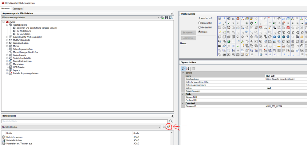

Ohh, so why you need any lisp? Simple macro _end or _mid assigned to the F key in CUI would work just fine!

Ok thanks I found how to do it now:
and even though for many ist obvious i thought i quickly screenshot how to do it:)
