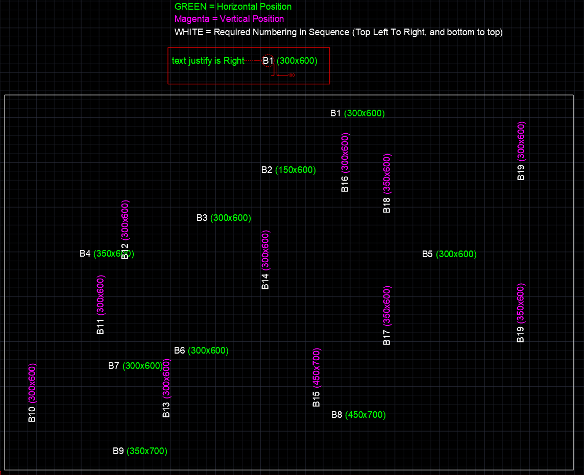

I have an existing text and I want to add numbering to it in a sequential manner,
from left to right and then bottom to top.
If any expert could provide me a Lisp code for this,
I would greatly appreciate it.
I have uploaded a file for reference.
Thanks in advance.

Is the format always B#?
Why do you have those tiny text below the beam size? Will those be included on the sequencing?
Tanookh
Thanks for reply  @pbejse
Format will be changed as per requirements, and yes, it includes numbering in sequence.
I tried this with the help of ChatGPT, but it's not working properly.
Can you please review this?

@Tanookh wrote:
... I want to add numbering to it in a sequential manner,
Correct me if I'm misunderstanding, but the image and drawing show the numbering being first from top to bottom with the 0° set and then left to right with the 90° ones.  Can you clarify?
One three-part glaring error:  1)  If the green and magenta Text objects already exist at rotations you want to remain, there's no need to check the rotation and correct it to the more readable direction [if that's what the rotation check is supposed to be for] -- just use the rotation of the existing ones for the new ones.  2)  Even if it were necessary to do that, it shouldn't check the relationship to 180° [and entity data would never store such a thing as less than negative 180°, nor for that matter as a negative value at all], but rather whether the rotation is greater than 90° but not greater than 270°.  3)  It's written as though rotation numerical values in entity data are in degrees, but they're in radians.
You have two B19's -- is that intended?
There's no accounting in the code for right-justification of the new ones [see the 72 & 73 entries in entity data], nor of moving the insertion point off.  Are the super-tiny ones the result of the code you posted?  Is there some way of "writing to" ChatGPT and describing what it got wrong?
It would need to separate the selection into a set of things at 0 [same in ° and radians] rotation and another set at 90° [i.e. (/ pi 2) radians] rotation.  Then it would need to sort the 0 set by insertion-point Y coordinate, and do its thing with those, then sort the 90° set by insertion-point X coordinate, and do its thing with those.

It sounded interesting to work out, so I came up with this, which worked for me in your sample drawing:

It accepts only Text on that particular Layer, and only left-justified, so that it can place the label Text appropriately in relation.
It could have *error* handling to first save and afterwards reset the current Layer and Text properties if you want, and have Undo begin/end wrapping, and remember what number you were up to and offer the next one as default on subsequent use if that's relevant, etc.
If you select any not at 0° or 90°, they should "work," but their sorting order will be in among, and numbered in order by the X coordinate of their insertion points along with, any 90° ones.

@Kent1Cooper Wow.👌
Its working for me.
Thank you so much for your help.🙂
