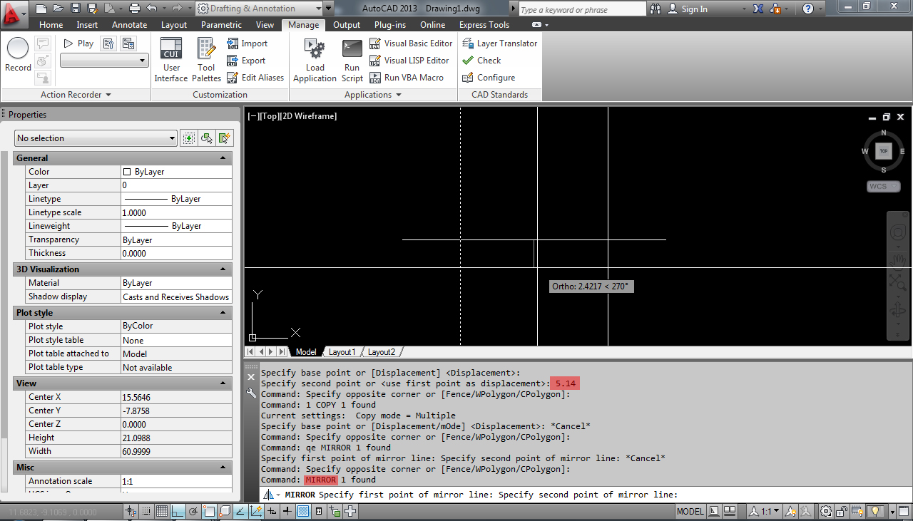

I always use the long way, get 22% of line then drawing xline offsetting it in 22% and mirror..
Do you have lisp that gives or calculate percentage of a line, polyline and arc.
Thank you.

@ryanic18 wrote:
hello, i need help with this one.
Welcome to these Forums!  This seems un-related to the Subject of this thread, which means that if someone answers it here, others looking for the same thing may not be able to find it.  I suggest you [first Search for something that already does what you want, and if you don't find anything,] start a new thread.
Kent Cooper, AIA
