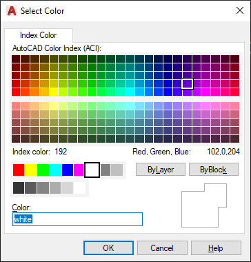

Hello everyone
I would like to create a lisp that creates a new layer
1. On the command line ask for the name
2. Please request the color, by the color chart, as below.
3. request the lineweight, on the command line.
This code is on the Internet, but it asks for the name in a text box, and it doesn't ask for the lineweight.

ВeekeeCZ
Possibly like this..
(defun c:NewLayer ( / n c w)
  (if (and (setq n (getstring t "\nLayer name: "))
	   (or (snvalid n 0)
	       (prompt "\nError: Name with invalid characters"))
	   (or (not (tblsearch "LAYER" n))
	       (initget "Yes")
	       (getkword "Layer already exists. Redefine? [Yes] <no>: "))
	   (setq c (acad_colordlg 0))
	   (setq w (getreal "\nEnter lineweight (0.0mm - 2.11mm): "))
    (command-s "_-layer" "_n" n "_c" c n "_lw" w n ""))
  (princ)
Kent1Cooper
Is not this enough?
(defun C:NLCW () ; = New Layer with Color and lineWeight
  (command "_.layer" "_make" pause "_color" (acad_colordlg 7 T) "" "_lweight" pause "" "")
  (prin1)
Kent Cooper, AIA
