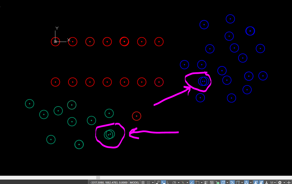

I need help regarding deleting overlapping objects (blocks), I tried overkill command but it is not working.
As I am a new user can somebody provide me with the lisp with the following conditions that it ask the user to select objects (by window selection) and delete any overlapping objects (partially or fully) irrespective of their color or name.
I have attached the sample dwg file.

(defun c:BlockOverlaps (/ LM:UniqueFuzz-p ss i ent pnt lst fuz sn)
  ;; Unique-p with Fuzz  -  Lee Mac
  ;; Returns T if a list contains items considered distinct to
  ;; a given tolerance
  (defun LM:UniqueFuzz-p ( l f )
    (or (null l)
	(and (not (vl-some (function (lambda ( x ) (equal x (car l) f))) (cdr l)))
	     (LM:UniqueFuzz-p (cdr l) f))))
  (if (and (setq fuz 220)
	   (setq sn (ssadd))
	   (setq ss (ssget '((0 . "INSERT"))))
    (repeat (setq i (sslength ss))
      (setq ent (ssname ss (setq i (1- i)))
	    pnt (cdr (assoc 10 (entget ent))))
      (if (LM:UniqueFuzz-p (cons pnt lst) fuz)
	(setq lst (cons pnt lst))
	(ssadd ent sn))))
  (command "_.REGEN")
  (if (> (sslength sn) 0)
    (sssetfirst nil sn))
  (princ)
pendean

A LISP would be overkill.. heh... When you run the overkill command you need to set your tolerance. Measure the distance between the objects and set that to your tolerance... In this case... try 300, it will remove any duplicate objects within 300' of each other.... the problem is... which one do you want to keep? 300' is a lot to simply be an "overlap"
